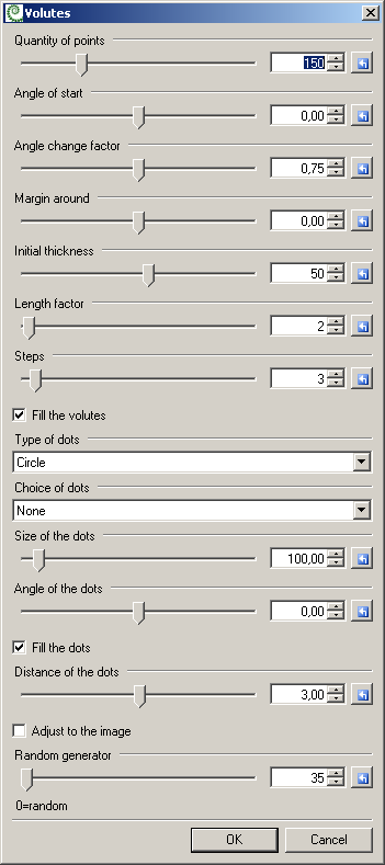

The User interface
This plugin is added to the menu Effects, submenu Render.
Posted Image
:Warning: The figure is pre-calculated then depending on how it turns, the result is scaled to fit in the area.
So most of the size amounts are only suggestive.
Quantity of points:
Set the length of the path.
Angle of start:
Choose the initial direction. As the volute is pre-calculated you could change it to try to fill the area.
Angle change factor:
Choose how slow/fast are the turns.
Margin around:
Set the margin to keep the result inside the area or make a zoom with a negative margin.
Initial thickness:
The volute starts width and is reducing till it's end to dispear. Set the initial width.
Length factor:
Set how often it could turn. Low value is often. High value give more like a straight line than a curve.
Steps:
The volute is made with a lot of segments. Each segment is made with 4 points.
With the steps amount you could overwrite the segments or leave a gap between them.
Fill the volutes:
If checked the volute is filled with the primary color. If unchecked you will have only the border lines. The brushwidth is used for the lines.
Type of dots:
The dots are some symbols added at the left or/and the right of the curves.
Available symbols are : circle, line, diamon, leaf, square, triangle.
See below the picture of the symbols.
Choice of the dots:
Dots could be added at the left or the right of the volute. Ok left-right is suggestive as the angle is always changing.
Size of the dots:
Set the size of the dots. The size is also decreasing as the thickness of the volute.
Angle of the dots:
Set the angle of the dots to turn them.
(no effect with circle and square 1.)
Fill the dots:
If checked the dots are filled with the secondary color. If unchecked you will have only the border lines. The brushwidth is used for the lines.
Distance of the dots:
Set the distance between the volute and the dots.
Adjust to the image:
Check the box to make the heigh and the width fit with the area.
Random generator:
Set to 0, it will be a random value so each change in the UI will give a new random figure.
Other amount will give always the same figure. try to find some values that give a nice volute...

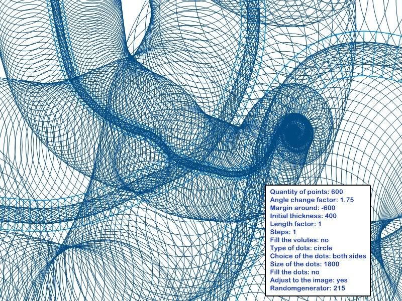

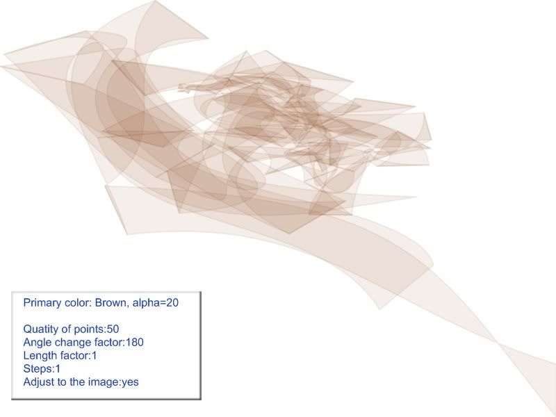

The Examples:
