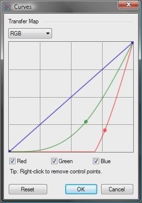

9. *This step is only if you want your rain to have color. If you want the rain to stay black than skip this step.* On your top layer select Adjustments > Sepia or Control + Shift + E :Sepia: . Then go to Adjustments > Curves or Control + Shift + M :Curves: and have it set to something like this:
Posted Image
*this is if you want your rain to be blue*
Note: The "Curves +" plug-in will work just as fine.
10. *Skip this step if you don't want colored rain.* Do step 9 to the other white layers. Just go to the other white layers and apply the sepia and curves color change. Don't use Control + F because it will apply that last used effect which should be motion blur.
